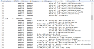

Hello Vamsi,
Now I am getting into below error;
I have taken snapshot of Disassembly;
this is linker of blinky. code fits into only one sector, sector6. Hence I have written the sector 6 only, in the flash.
Do I need to write anything , other that this in order to execute blinky after jump instruction?
Also, when I observe map file of blinky, I see driverlib at the start address of sector 6: 0x86000.
what should be taken care to have executeble function at start address?

Hi Yogini,
There is no need to place a jump. You might have noticed that the codestart section is mapped to the flash entry point (BEGIN) in the linker command file.
The code in that section will call C initialization routine and it in turn will call the main of your application.
