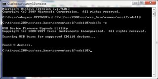

  • Hi
    I try a new demo board 280049C LAUNCHpad but still cannot foind the XD110. xdsdfu -e found 0 devices but device manager seems ok. See below.
    I am running WIndows 7 64 bits and I also have CCS v10.1 installed with CCS v12.
    Thanks Arnaud

  • Forgot to say that I did not touch/change the demo board and all power LEDs are ON.
    If you are using LAUNCHXL-F280049C, open the target configuration file, and make sure you are XDS110, in 2-pin cJTAG mode.
    Here is users guide :
    C2000 Piccolo F28004x Series LaunchPad Development Kit (Rev. B)
  • I still cannot find the launchpad. Board is working on a different computer with same cable. Displayed also same LEDs. I did fallow the user manual but still no luck. See image below.
    Thanks, Arnaud

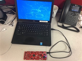

  • Do you have more than one board connected which has XDS110 emulator?
    Can you send the picture of your setup?
  • Only 1 XDS110. See setup.

  • Can you update the firmware of xds110?
    Go to C:/ti/ccs1200/ccs/ccs_base/common/uscif/xds110
    Open the readme file : XDS110SupportReadMe.pdf
    Follow the instruction to update the firmware.
    Let me know how it goes.
  • cannot find device.

  • Do you have any other device with XDS110?
  • I tried a new same demo board but same issue.
  • Okay. So looks like board is not the issue. Something on your setup.
    Did you test with other setup/laptop, different USB port, or maybe Firewall setting?
  • Yes, I try on a different laptop and it is ok. Only on my laptop where I get this issue. It is Windows 7 64 bits.
