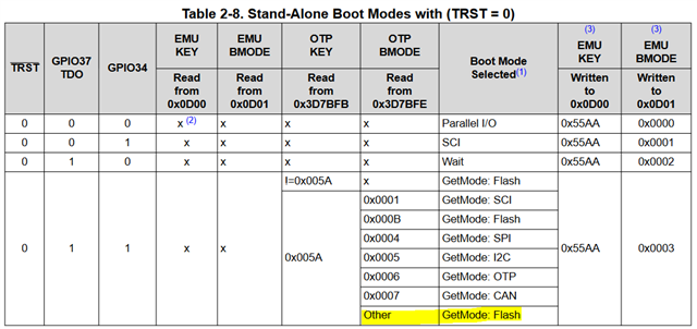

I am using a custom prototype board containing TMS320F28069. I have changed the values of the OTP_KEY and OTP_BMODE to boot my device from the CAN Bus, in a previous project. Is it now possible for me to boot to it's flash memory in some way?
  • Hi Rahal,
    Are you wanting to program the device's Flash over CAN and then boot from some Flash entry point? Or something else?
    Kevin
    No, I no longer wish to use CAN to program the device. I want to program the device's flash with the CCS debugger (which I have already done) and run the device in standalone mode afterwards (i.e boot to flash memory).
    The problem I have is, that since the OTP_KEY and OTP_BMODE have been written, the device will no longer boot to flash in standalone mode. Is there a workaround to this?
    Thanks!
  • Hi Rahal,
    OK, understand your question now. Are you not wanting to change the OTP_KEY and OTP_BMODE values further (believe you can only reduce the values however, i.e. program bits to zero)?
    Let me check if there's a way this can be done and get back to you.
    Kevin
  • Hi Rahal,
    Do you need to return to using CAN boot mode later? Or are you only wanting to test with Flash boot from now on?
    I believe you can program OTP_BMODE to an 'Other' value less than 0x0007 (i.e. 0x0003 for example) for Flash boot. However you will not be able to change it back to 0x0007 (bits can only be programmed to 0's).
    Kevin
