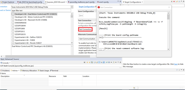

Hello, i have a TMDSCNCD28379D with a dev kit, is their anyway to manually test JTAG connection with xds100v2 black hawk that i purchased? We designed a board with a TMS320F28377DGWTEP but are having issues with our jtag programming. Attached is how we ha ve our JTAG connected to our processor if anyone can help.
  • Is there a pinout sheet that should tell me what the voltage is on each pin, or what the outputs should be so i can read them?
  • Hi Jonathan,
    I would be curious to see what happens when you use CCS to launch the Target Configuration for the CCS Project, then use the 'Test Connection' option. This tests the JTAG connection to your device, and its output log may give some clues about what is going wrong. Please post your output log from 'Test Connection'.
    If you are able to look at your signals with an oscilloscope, you should see the same patterns as I do when I 'Test Connection' to my device with the XDS100V2. The image below shows TDO (yellow), TMS (purple), TCK (blue), and TRST (green). This is the start of the 'Test Connection' sequence that I captured as a single sequence, triggered on the falling edge of TMS. All signals are 3.3V digital signals.
    If you zoom in more closely, you should see this same pattern at the start.
    Please let me know if you see something different, or if you notice signal integrity issues when you look at you signals on the oscilloscope.
    If you would like to know more about what the signals are doing, I would recommend that you read about the JTAG TAP state machine, and the IR and DR registers, though that may not be necessary to debug this.

  • Hello, this is what i receive. Oddly enough, i don't see TDO resetting.

  • [Start: Texas Instruments XDS110 USB Debug Probe_0]Execute the command:%ccs_base%/common/uscif/dbgjtag -f %boarddatafile% -rv -o -S integrity[Result]-----[Print the board config pathname(s)]------------------------------------C:\Users\Eric\AppData\Local\Texas Instruments\
        CCS\ccs1040\0\0\BrdDat\testBoard.dat-----[Print the reset-command software log-file]-----------------------------This utility has selected a 100- or 510-class product.
    This utility will load the adapter 'jioxds110.dll'.
    The library build date was 'Jun 25 2021'.
    The library build time was '11:45:30'.
    The library package version is '9.4.0.00129'.
    The library component version is '35.35.0.0'.
    The controller does not use a programmable FPGA.
    The controller has a version number of '5' (0x00000005).
    The controller has an insertion length of '0' (0x00000000).
    This utility will attempt to reset the controller.
    This utility has successfully reset the controller.-----[Print the reset-command hardware log-file]-----------------------------The scan-path will be reset by toggling the JTAG TRST signal.
    The controller is the XDS110 with USB interface.
    The link from controller to target is direct (without cable).
    The software is configured for XDS110 features.
    The controller cannot monitor the value on the EMU[0] pin.
    The controller cannot monitor the value on the EMU[1] pin.
    The controller cannot control the timing on output pins.
    The controller cannot control the timing on input pins.
    The scan-path link-delay has been set to exactly '0' (0x0000).-----[An error has occurred and this utility has aborted]--------------------This error is generated by TI's USCIF driver or utilities.The value is '-233' (0xffffff17).
    The title is 'SC_ERR_PATH_BROKEN'.The explanation is:
    The JTAG IR and DR scan-paths cannot circulate bits, they may be broken.
    An attempt to scan the JTAG scan-path has failed.
    The target's JTAG scan-path appears to be broken
    with a stuck-at-ones or stuck-at-zero fault.[End: Texas Instruments XDS110 USB Debug Probe_0]
    Heres the test connection results. I forgot to mention that we connected pin 5, to ground by accident in our schematic but we fixed the board but we might have fried the XDS110V2 debug prob. I attached a image and highlighted in red where the 3v3 is shorted to ground. Do you think that can fry the debugger? I'll try and get some better oscilloscope pictures.

    I do not think that would fry your debugger. Could you also try testing connection with the XDS100-V2 and posting that log? I am trying to determine if there is a problem with the physical scan path, and it is not yet clear to me from this log, as this error could be caused by a few things. You may also want to try 'Test Connection' with a lower TCK frequency and see if that changes the output. The setting for the TCK frequency can be found in the 'Advanced' Tab of the Target Configuration.
