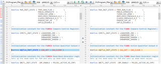

2) Regarding the setting of PWM wave:
On the left is f2803xpwm.h(\TI\controlSUITE\libs\app_libs\motor_control\drivers\f2803x_v2.1)
On the right is f2803xpwm_PM.h(\TI\controlSUITE\development_kits\DRV830x-HC-C2-KIT_v105\PM_Sensorless)
As you can see on line 36, why is the setting of AQCTLA different with the same configuration?

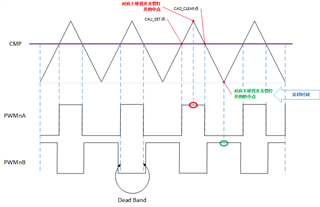

3) The following figure shows the sampling instant, why is the configuration different?
On the left is f2803xileg_vdc.h(\TI\controlSUITE\libs\app_libs\motor_control\drivers\f2803x_v2.1)
On the right is f2803xileg_vdc_PM.h(\TI\controlSUITE\development_kits\DRV830x-HC-C2-KIT_v105\PM_Sensorless)
    Could you help check this case? Thanks.
    That depends on the inverter hardware. Please refer to the configuration used in the project, or change it according to the hardware you used.
    Thanks for your help.
    Regarding the Q3:
    Below is CAD_set + CAU_clear. Since sampling is done through the sampling resistor of the lower leg, sampling is done at the middle of the lower leg switch opening, that is, at the middle of the lower leg PWM waveform. Therefore, the triangle wave period is the vertex instant that triggers sampling:
    The figure below shows CAU_set+ CAD_clear, again due to the current captured through the lower leg sampling resistor, the sample is selected at the middle point when the lower leg switching tube is on, that is, when the triangle wave counter is 0:
    Is the above understanding correct?
    Thanks and regards,
    Cherry
  • You may take a loot at the application note of the project you want to use. The ADC trigger and sampling time point depend on the control algorithm and the current sensing circuit on the hardware.
    It's difficult tell you that it's correct or incorrect that should be related to the project as mentioned above. You may refer to the example project directly if you are working a TI EVM kit.
