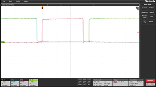

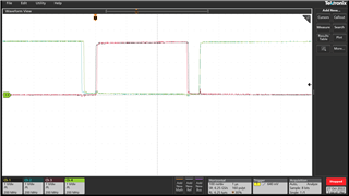

Measurement :
Measurement data:
Channel 1: ePWM[1]: Output A
Channel 2: ePWM[1]: Output B
Channel 3: ePWM[2]: Output A
Channel 4: ePWM[2]: Output B
Epwm clock frequency = 120 MHz
TBPRD = 600
up-down-count mode
RED of ePWM[1] = 10
FED of ePWM[1] = 10
CMPA of ePWM[1] = 20
CMPAHR of ePWM[1] = 32768
RED of ePWM[2] = 10
FED of ePWM[2] = 10
CMPAHR of ePWM[1] = 0
The alignment of Channel 1 and Channel 3 are as expected. Because I use the up-down-count mode the on-time of Channel 1 is one clock cycle (1 / 120 MHz = 8,33 ns) longer as the on time of channel 3, aligned to the center of both on-times. Channel 3 and Channel 4 are also fine. But the blanking times of ePWM[1] are wrong. As you can see on the cursors time measurement, the difference between the complemntary oututs of the two ePWM modules are one clock cycle, instead of an half clock cycle.
How can I achieve proper behavior of the dead band submodule in hr-mode with complementary output signals?
Thank you in advance.

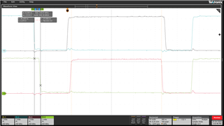

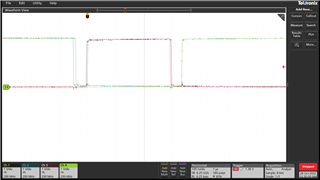

    Thank you very much. I already know the HRPWM_ex4_duty_updown_sfo example. It uses the hrpwm, but not the dead-time submodule.
    There are 52 msteps per pwm clock cycles. Therefore one mstep is about 160 ns. Because of autoconversion the CMPAHR value of 32768 (2^15, or 26 mstep) leads to 4,167 ns of high resolution time, which you can see on the waveforms by comparing Channel 1 with Channel 3. CMPAHR of Channel 3 is equal to zero.
    The problem is that the falling edge of Channel 2, which is the complementary ePWM output of channel 1, is 8,333 ns before the falling edge of Channel 4, which is the complementary output of the second ePWM module with CMPAHR cleared respectaly. Both rising edges of the complementary signals are synchronous. So the on-times of the ePWM modules are not center aligned.
    In this configuration I expect just 4.167 ns difference between both transition, which yields to centred aligned waveforms.
    This is the reason I trink something is wrong in my configuration.
    Stefan

    I wrote in my first message that the delay of the dead zone module is not as expected. This meant the RED and FED times of the Dead-Band Generator submodule. In up-down-count mode with HRPWM and center-aligned pulses, a CMPAHR value of 2^15 causes an increase of the pulse by a total of one time-base clock cycle, compared to a CMPAHR value of zero. This is what I wanted to describe.Sorry for the confusion.
    Back to my question or rather problem:

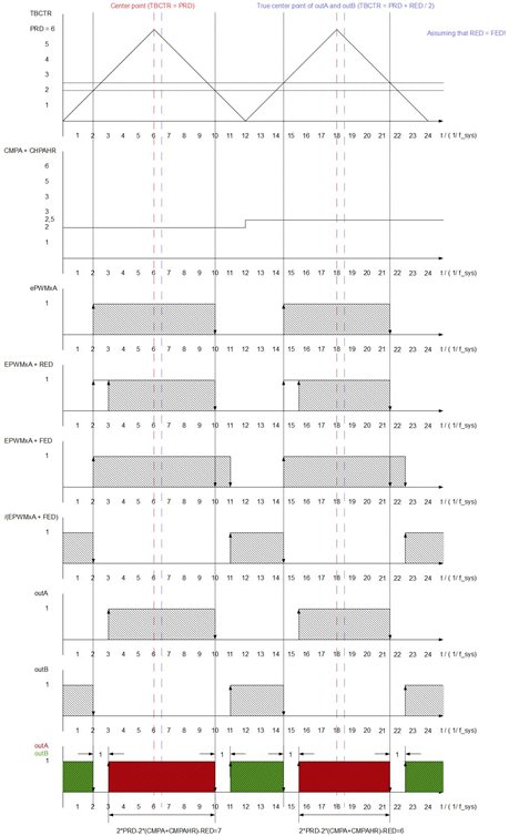

    I want to generate the ePWMxA and ePWMxB outputs in active-high complementary mode (AHC), as described on Page 2195 of the TRM (SPRUIW9A). I have created a drawing (TBPRD = 6, RED = FED = 1) that shows the desired output behavior of my ePWM modules:
    This works fine, but only without the HR-mode turend on. I expect the following behavior in the HR mode:
    Please note that the action-qualifier conditions are not the same as in my first post. There are inverted. This is the code of the action-qualifier configuration shown in the figure above with the high resolution mode turned on:

    Here is a measurement of the code from the listing:
    Channel 1: ePWM1A
    Channel 2: ePWM1B
    Channel 3: ePWM2A
    Channel 4: ePWM2B
    The parameters of the measurement are shown in the following screenshot:
    The Time-Base clock frequency is still 120 MHz. Again, the RED and FED times of the module Dead-Band Generator submodule are different, as can be seen in the measurement. The RED time between Channel 1 and Channel 2 (both ePWM1) is one half Time-Base clock period too long. And the FED time between the mentioned Channels is one half Time-Base clock period too short.
    Do you expect this behavior? Or should both complementary outputs be symmetrical, as drawn in my picture above?
    Stefan

  • Hi Jason,
    Thank you very much. With your two lines of code and writing both CMPAHR and CMPBHR registers with the same value I get these waveforms:
    Channel 1: ePWM1A
    Channel 2: ePWM1B
    Channel 3: ePWM2A
    Channel 4: ePWM2B
    Parameters of the obove measurement:
    Because CTLMODEB and HRLOADB specify the behavior or action taken with the CMPBHR values, I tried to set also the EDGMODEB bit in the HRCNFG register to 0x3 (MEP control of both edges). The complete ePWM configuration code is as shown below:

    Now it works as expected, see the following measurement and the corresponding parameters (Unchanged, with the exception of the EDGMODEB bits):
    Channel 1: ePWM1A
    Channel 2: ePWM1B
    Channel 3: ePWM2A
    Channel 4: ePWM2B
    Thank you very much for your help. I never thought that CMPBHR must also be used for this mode. I did not find anything in the TRM about this.
    Stefan
