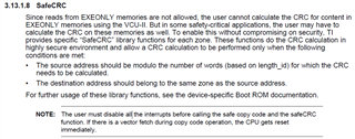

ad.1. will Fapi_doBlankCheck() work when EXEONLYSECT is enabled on that flash location?
ad.2. Can you send me a link to the BootROM documentation where SafeCRC funcion is described? I cannot find any document about API for that.
The most important question for me is still:
Is it possible to erase, and then program the section that is in the secured zone and has enabled EXEONLY property?
Piotr Romaniuk
Yes, you can perform erase and program operation on the EXEONLY sectors but read verify may not work.
Vivek Singh
Also on SafeCRC , high level detail is already mentioned in security section of device TRM. The function detail is not provided to user.
Vivek Singh
Hi Vivek,
Can you send me a link to the Boot ROM documentation where it is described?
I cannot find it.
Piotr Romaniuk
That statement basically referring to content in section "4.10.7 Secure ROM Function APIs".
Vivek Singh
Also on below -
This will not work for EXEONLY secure sectors.
Vivek Singh
