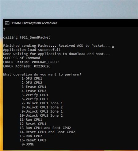

After converting the out files of Core1 and Core 2 to the txt format and running serial_flash_programmer.exe
I succeed in loading Core 1 but fail at loading Core 2 - I get Verify Error at address 0x090002 and the program not running.
When I load the out file with UNIFLASH there is no error and no issues with address 0x090002, and afterwards the program running ok.
Please advice what can I do to fix this ?

  • Zvi,
    Can you show an image of the error occurring or what the error code/message is that stops the hex2000? Is it possible to update the compiler version to the latest build? Currently on 22.6. Will look into this specific version of C2K.
    Charles

  • Hello Charles,
    • ALIGN(8) - after compiling with this change and trying with serial bootloader the result was a different error:
    ERROR Status: PROGRAM_ERROR
    ERROR Address: 0x220026
    • Compiler version 22.6 cannot be used because the program compiles OK and not running correctly
    I don't understand why there is a different error after changing to ALIGN(8) and why the address is of EMIF1_CS2 which we don't have ?!
  • Zvi,
    Success of command is a good, it means that the operation was successful. The error of PROGRAM_ERROR indicates that the application file has sections not mapped to flash memory. The error address is 0x220026, which is odd. Now that you are using ALIGN(8), can you try to look at your application linker cmd file to see if any section is mapped incorrectly? There is a memory map for the device as well that shows the range of memory available.
    Charles

  • Hi Zvi,
    After looking at the cmd files, I see that you've used the entirety of Flash sectors A to N for your flash use, however as noted per the errata advisory in the example linker cmd file, FLASHN_RSVD must be protected (origin = 0x0BFFF0, length = 0x000010) to avoid "Memory Prefetching: Beyond Valid Memory". Is it possible to avoid programming this section for your application, try to change sections used?
    Let me know about this.
    Charles

  • Zvi,
    Here is a link to the errata for the TMS320F2837xD. The advisory on the prefetching can be found on page 32, it can also be found in the example files (2837xD_FLASH_lnk_cpu1.cmd in the device's LED example where it discusses FLASHN_RSVD).
    Charles
  • Thanks, I am using F28379D and this errata is not for this device
    And why is it that Core1 is flashed ok but not Core2 ?
  • Zvi,
    Will need a bit more time to go over the files presented, I've done a check on the memory ranges, and they seem fine. As far as the errata is concerned, will need to consult with others on this. Will get back to you as soon as possible.
    Charles
  • Hi Zvi,
    Testing the linker cmd files, will try to reproduce the issue with debug. This is likely a programming issue.
    To note, the errata does apply to the F28379D device as well. Will see about having the app note updated.

  • Hi Charles,
    Please feel free to update me if any progress was made regarding the Core2 serial programming.
    Zvi.

  • Hi Zvi,
    Charles asked me to take a look at this post.
    Quick question: I noticed below in your linker cmd file.  Could you check your map file to see what is assigned at address 0x220026 that you reported?

    May be some initialized content is mapped there and hence flash kernel is trying to program it (which will fail since it is not flash address).
    Thanks and regards,
    Vamsi
  • Hello Vamsi,
        I just looked at the map file and there are no sections: .farbss nor .farconst  .
        We use same linker cmd file for core 1 and there are no issues while programming it ..
    Best regards, Zvi.
  • Hi Zvi,
    I am currently not able to replicate the issue. Would you be available to have a call over it soon so that we can diagnose it together?
    Charles
