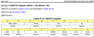

  • Hi Bingo,
    You should be able to reset the eQEP module by writing to the software reset bit of the QEPCTL register, the description of which is shown below:
    Peter
  • Hi Peter,
    Unfortunately, I tried to reset QPEN and then reenable QPEN=1,However, it is still not possible to reset the position counter automatically when the return to zero pulse occurs.
