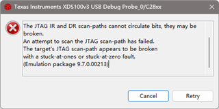

TMS320F28335: Error Error-233 was suddenly reported when the program was burned. It was always normal to burn the program before. It is okay to burn other boards with this emulator .
Part Number: TMS320F28335
Hi Team,
There's an issue form the customer need your help:
Is this chip locked?
Connection emulator error:
first:

Second:
[Start: Texas Instruments XDS100v3 USB Debug Probe_0]
Execute the command:

An error occurred while hard opening the controller.
-----[An error has occurred and this utility has aborted]--------------------
This error is generated by TI's USCIF driver or utilities.
The value is '-233' (0xffffff17).
The title is 'SC_ERR_PATH_BROKEN'.
The explanation is:
The JTAG IR and DR scan-paths cannot circulate bits, they may be broken.
An attempt to scan the JTAG scan-path has failed.
The target's JTAG scan-path appears to be broken
with a stuck-at-ones or stuck-at-zero fault.
[End: Texas Instruments XDS100v3 USB Debug Probe_0]
Could you help check this case ?Thanks.
Ben
  • Hi Ben,
    I do not think that the source of your problem is a locked chip, as your 'Test Connection' would still be able to succeed. If the device was locked, you just would not be able to read the device memory. There are many different issues that could cause the errors that you posted. Could you share the schematic of your design? How is the debugger connected to the device? If you have long traces, have you tried lowering the TCK frequency?
