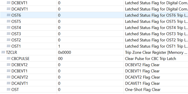

I am using the OST tripzone to drive PWMs LOW in upon trip condition set Through GPIO.
The GPIO is active low I measured it and ensured that initially it is high and goes when the trip condition occurs
I don't know the correct way to clear the interrupt flag, the trip condition occurs and I am using  EPWM_clearTripZoneFlag API to clear the OST bit in TZCLR register however in the debugger the bit is not being cleared. Please find photo attached
Here's how I clear the flag in my application
ISR_FUNCTION void INT_PWM_HV_T1T2_TZ_ISR (void)
// Re-enable the OST Interrupt
EPWM_clearTripZoneFlag(PWM_HV_T1T2_BASE, (EPWM_TZ_INTERRUPT | EPWM_TZ_FLAG_OST));
// Acknowledge this interrupt to receive more interrupts from group 2
Interrupt_clearACKGroup(INTERRUPT_ACK_GROUP2);
I think the assert condition could be the issue here right?
Please guide me what is correct way to clear the OST flag after the trip condition occures
