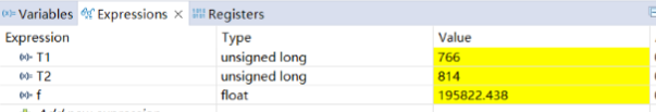

Hi, I'm reporting an error using 28335/28035 to capture a signal below 500Hz, and I don't know what the specific cause is because it's a stable capture in 500Hz-500kHz capture. I reviewed the book and data manual to see if the counter was not reset to zero in time, but no change was made after configuring the registers, and then I removed the configuration code, which was modified based on the 28335 routine. I hope my friends can teach more. The following are the error symptoms and codes:

Could you check this case please?Thanks.

    In my opinion, the value ''f'' represent the frequency of the captured signal, which should be below 500Hz.
    I'll go talk to the customer to confirm the issue.
  • Hi Ben,
    Looking it the ISR code, it looks like customer is not using eCAP2. Even for eCAP1, it is only using two CEVT1 and CEVT2.
    Can you also check what is the expected value? Does not it work on only on low frequency? At what frequency it stops working?

    I'm sorry to return to your message this late and thank you for your response to my question, specifically, that I cannot capture the frequency between 0-500 Hz to ensure that the data is stable and accurate, the closer I get to 0 Hz, the less I can capture the corresponding numbers. I just opened a capture window, used two time stamp registers, the expected value was that I could capture the frequency at 50Hz, I was considering if it was caused by the counter overflow. But I just looked at the data sheet and found that there are stop and start registers, TSCTRSTOP and TSCTR, that cannot reset it to 0 when the second event is captured, going into the interrupt. I was considering if statements to determine if the counter overflowed, no overflow output the normal capture value, and overflow was calculated by the algorithm, which is not implemented yet, and I do not know the result.

    ECAP should work  properly at 0 - 500Hz, but I should not be able to resolve its counter overflow.

    Are you not getting eCAP ISR when signal is 0-500Hz or CAP1/4 counter values are invalid?
    I just tested on my setup with 350Hz ePWM signal. It is able to capture the events.
