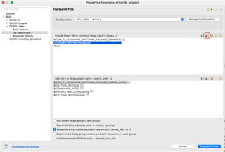

  • Hi Gokhan,
    If you do not want to use SysConfig, then follow following step:
    1. Exclude c2000.syscfg file from project
    2. In the main C file, remove following line:
    3.     //#include "board.h"
          //#include "c2000ware_libraries.h"
          // PinMux and Peripheral Initialization
          //Board_init();
          // C2000Ware Library initialization
          //C2000Ware_libraries_init();
    4. Now open project setting, and remove this from your library
    Save, and rebuild the project.
