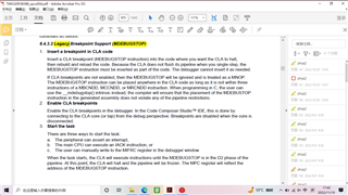

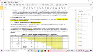

There are two descriptions of the CLA debug breakpoint settings in the 388TRM document
MDEBUGSTOP1 clears the pipeline (flush)
MDEBUGSTOP is an older version of how breakpoints are set

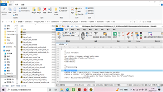

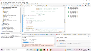

But I see that the 388 routine does not use the new MDEBUGSTOP1 breakpoint setting method, but the MDEBUGSTOP is used instead
And changing to MDEBUGSTOP1 compilation will get an error
Question 1. How should the MDEBUGSTOP1 mentioned in 388TRM be used

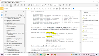

以下是F2803x_DEV_USER_GUIDE.pdf的内容,问题也一并发达这个帖子里
Question 2. TBCTL is not an EALLOW-protected register, and why use __meallow and __medis for this example
