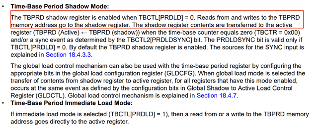

Crane,
There are two different modes that we have referenced together in this thread.
One is the standard SHADOW mode which is present on a lot of the registers.
The other one is an additional global load mode which I don't think you need.
Correct me if I'm wrong you are just trying to use the standard shadow mode? I can point you to an example of this.
I am not sure as I don't think I already completely understand the difference. I am using global load mode as suggested in all the relevant documents to update all registers at the same time when the trigger events happens.
Anyway, I don't care as long as it can help switch the frequency while all PWM2, PWM3 and PWM4 changes accordingly.
Crane,

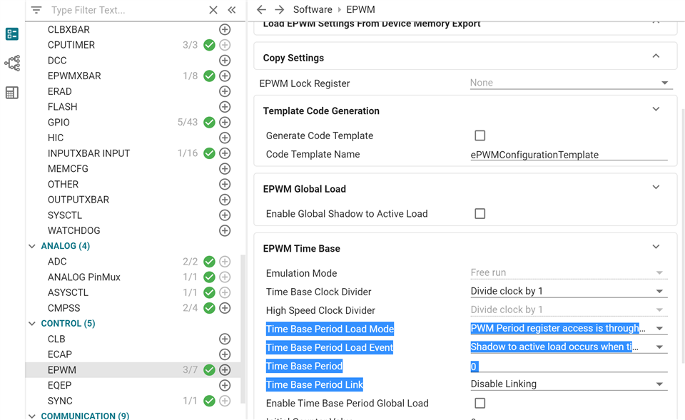

The normal shadow mode is separate from the global load. I recommend normal shadow load mode.
Take a look at this example:
Nima
This uses the SysConfig tool as well. For PRD to be in shadow mode:
These are the four options. If EPWM2/3/4 all are the same, the LINKING feature could help as well.

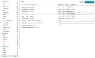

You are trying to synchronize EPWM4 to EPWM2?
This device has a synchronization chain:
For you to be able to synchronize your Time base modules you have to pass the synchronization signal through the chain.
The chain of EPWMs cannot be longer than 4 I believe. Including the SYNC master EPWM.
You can sync:
EPWM2-EPWM3 very easily as shown.
You can also sync EPWM1-2-3 as shown.
You can sync EPWM1-4-5 as shown.
For you to be able to sync EPWM2-3-4, you have to set up EPWM1 as the sync master and configure all needed muxes.
In the GUI configuration tool, you have the SYNC module that shows how to configure the muxes in the image above.
I thought of that the tried to use PWM1, 2, 3 to replace PWM2, 3, 4. It still didn't work. Same result as using PWM2, 3, 4.
Also the EPWM1-2-3 is the same as the example 3 I sent you. At least the sync part of it with PHSEN.
Did you configure the SYNCOUT for each EPWM?
I didn't config them this way before. Now I made the changed and the result stays the same.
When using PWM1, 2, and 3, only PWM2 is enabled phase shift as only PWM2 needs the phase shift.
When using PWM2, 3, and 4, only PWM3 is enabled phase shift as only PWM3 needs the phase shift.
Can you share your EPWM synchronization chain configuration? for both scenarios.
Yes, it is enabled for PWM2. As only it has a phase shift to PWM1. It is enabled in application, not in Sysconfig.
Just realize that PWM1 sync is re-configured in application. The configuration I posted previously is in Sysconfig.
Then this should be all that is needed to sync PWM2 and PWM1.
You can follow the same between PWM4 and PWM1. Given the settings you showed me in the SYNC module.

You want EPWM1-2 synced and EPWM1-4 synced. Correct?
Please see the attached file.
We want EPWM2 has a phase shift to EPWM1, EPWM4's rising edge is EPWM1's falling edge, and EPWM4's falling edge is EPWM2's falling edge. And we want this works when the frequency is changed on the fly.
Right now, everything works fine. Even the duty cycle of EPWM4 changed correctly with the frequency change. Only thing left is that EPWM4's rising edge is not always EPWM1's falling edge.
I think the cause is EPWM4 is not synced with EPWM1 when the frequency is switched.
The code really well put together. I dont see a EPWM_enablePhaseShiftLoad(myEPWM4_BASE); line of code to sync EPWM1 and 4.
The phase shift is between EPWM1 and EPWM2. There is no phase shift between EPWM4 and EPWM1. But, as EPWM4 is relevant to both EPWM1 and EPWM2, so EPWM4 and EPWM1 are somehow related to the phase shift.
That is the problem. From the result, I don't think they are synced. How to sync EPWM4 and EPWM1? In SYNC Cynchronization in Sysconfig, EPWM4 sync in source is set as 'SYNC IN SRC EPWM1SYNCOUT, also tried SYNC IN SRC EXTSYNCIN1, none of them work.
You still need to have this line of code:
This will sync it to EPWM1.
Yes, it works now. Thank you for much. Finally it is resolved.
