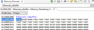

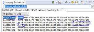

Finally, after packet reception myEthernet_receivePacketCallback() is called:
Ethernet_Pkt_Desc *myEthernet_receivePacketCallback(
    Ethernet_Handle handleApplication,
    Ethernet_Pkt_Desc *pPacket)
    Ethernet_Pkt_Desc *p;
    GPIO_writePin(6,1); // PIN 54: about 79 us after rising edge of GPIO 0 for 64 byte packets
    p = Ethernet_getPacketBuffer();
    GPIO_writePin(6,0); // about 80 us after rising edge of GPIO 0
    return p;

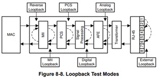

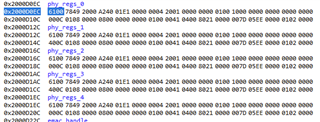

I have fiddled a bit with EMAC options regarding duplex and 10M/100M speed:
    Ethernet_setMACConfiguration(Ethernet_device_struct.baseAddresses.enet_base, ETHERNET_MAC_CONFIGURATION_FES); // 100 Mbps
    // Ethernet_clearMACConfiguration(Ethernet_device_struct.baseAddresses.enet_base, ETHERNET_MAC_CONFIGURATION_FES); // 10 Mbps
    // Ethernet_setMACConfiguration(Ethernet_device_struct.baseAddresses.enet_base, ETHERNET_MAC_CONFIGURATION_DM);  // Full Duplex mode
    Ethernet_clearMACConfiguration(Ethernet_device_struct.baseAddresses.enet_base, ETHERNET_MAC_CONFIGURATION_DM);  // Half Duplex mode
and I have made the following observations:
  • The EMAC speed (FES bit) appears not to have any influence on the transmission times.
  • Packet reception is delayed by another 2 us when duplex mode (DM bit) is enabled.
  • When I increase the packet size by 10 from 64 to 74 the reception is delayed by another 8 us (which looks as if there is somewhere a 10 Mbps bottleneck).
Is this to be expected? I'm afraid I have some serious mistakes in my EMAC configuration but I don't know where to look.
