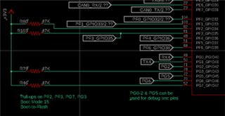

Contract Manufacturer here that has made a new revision of a PCB and now I am unable to program the C28 side of the CPU through the FTDI (FT2232HL) USB programmer. I can however program the M3 side without an issue AND my customer has been able to program the C28 side using a Spectrum JTAG programmer. I receive this error while trying to load flash into the C28:
Texas Instruments XDS100v2 USB Debug Probe/C28xx_0
Error connecting to the target: (Error -1015 @ 0x0) Device is not responding to the request. Device may be locked, or the debug probe connection may be unreliable. Unlock the device if possible (e.g. use wait in reset mode, and power-cycle the board). If error persists, confirm configuration and/or try more reliable JTAG settings (e.g. lower TCLK). (Emulation package 9.9.0.00040)
I have 5 boards. They all exhibit the same behavior while trying to program the C28 via the XDS100v2. I did not change the JTAG circuit at all in the PCB revision (unless there is a manufacturing issue with the boards) and this problem did not persist on the the previous boards. 3 of the new boards are using CPUs that were removed from the previous revisions board and 2 have brand new CPUs. The 3 that were removed from previous boards already were programed and the code runs but I am unable to erase or reprogram them now (C28 side).

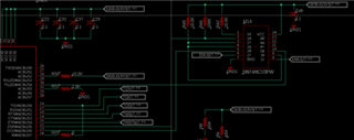

The XDS100v2 debugger is powered by the USB port and isolated from the CPU. On these new boards I did have to change the isolators from a ISO7241 to a ISO7231 b/c I could not get the ISO7241. Both are 25Mbps so I don't see why that would be the issue. I have done 'test connection' tests in Code Composer and with JP1 & JP2 on, succeed at all TCLK speeds.
Below are the relevant parts of the schematic. The CPU is on the +3V3-GND side and the FTDI chip is on the DEBUG3V3-GND1 side. JP1 jumper is installed to program via USB and removed to program from the 14 pin JTAG header. I am not sure what the purpose of the JP2 jumper is. It is required to make one of the JTAG tests succeed but is not required to program the M3 side. CPU is set to boot in MODE 15 - Boot from Flash
My procedure for programming the boards has been to gradually increase voltage on the new board making sure all the voltage regulators work. I then plug in the USB cord, test voltages, open FTDI Prog, apply and program the XDS100 template to the FTDI chip. I then install the JP1 & JP2 jumper, open Code Composer and do a 'Connection Test' on the JTAG. I then open UniFlash and program the M3. I then try to program the C28 and get the above error. I have tried using slower TCLK down to 10kHz. I have erased the M3 and tried to program the C28 first. I have changed R41 and R67 to 2.2K (EMU pull ups) and have removed R20 (TCLK pull up).
It appears as if the JTAG connection is good from the successful connection test and being able to program the M3. I don't believe the C28 side of the CPU is bad because using a JTAG programmer it can be programmed and is running the code. What can I check or do from here?

  • Eric,
    Can you probe EMU0/EMU1 at the local C2000 pin and note the value when you are trying to connect, or even just when the board is powered with no JTAG connected?
    If these are treated the same even with different isolators I'm not sure why there would be a difference, but I know that standard ARM does not use these pins and C28x does(sampled on the rising edge of TRSTn).  Maybe more a hunch/clue why ARM is OK and C28x is not.
    We want to see both as high/VDDIO level when trying to connect(for normal operation).
    Matthew
  • Matthew, THANK YOU! for this incite. Looking at this I found both the EMU0 & EMU1 where low on the C2000 side. They had no voltage change no matter what I tried. If I removed the JP1 (enable USB programming) jumper then EMU1 would go high telling me that the digital isolator (U9) was holding it low. I then started to look into that circuit. I am not sure what exactly the U14 SN74HC03 does but I found it is a NAND gate with open collector outputs. Probing the lines I found that one of the outputs should have been high but without any pull up resistors it was still low. I added pull up resistors to EMU0 & EMU1 on pins 3 & 4 of U9 and now I can connect and program the C28 side. Not sure why this worked on previous boards. I will have to look into that but for now this has solved this problem. Your help was greatly appreciated.
  • Found that the previously used ISO7241 digital isolators had internal 1Meg pull up resistors on the inputs. The ISO7341 used on this build (could not find any ISO7241 instock) do not have internal pull ups on the inputs therefore the outputs 2Y (EMU0) and 3Y (EMU1) of the SN74HC03 were never able to go to a logic 1. Going to replace the SN74HC03 with a SN74HC00 so the output are push pull instead of open drain.
