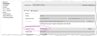

  • If it's just the compiler version then change it here:
    This is stored in the .cproject file....I think.

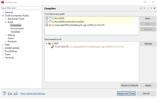

    This was the defaults root in preferences ,and I want to add a new root  just like the next photo that I copy the compiler what I used into my project (this the same mean I copy the compiler in the desktop). This way just was changing the settings in IDE preference.
  • Jack,
    I think 'In Tool Discovery Path', CCS compiler installation path is listed earlier than your custom path. As same version of compiler is available at both location, so it picks up from CCS compiler folder.
    You can try to install 22.06 version compiler to custom location, and then try to pick that version in IDE, it should use that.
    Regards, Santosh

    First picture is the IDE->preference compiler default, and it's just the compiler root in my project unselected, and the same condition with the SDK.

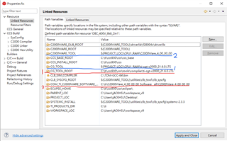

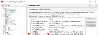

    The third picture is my project properties, red lines pick up from IDE, blue lines are the root I hope. And 1 just compiler, 2 would be the SDK. Now I try to cover the red roots with the blue roots. Because it's too many variables that I could not understand and change by myself just like the fourth picture.

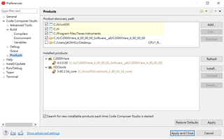

  • Your screenshots are of the Windows -> Preferences dialogue but the answer to your question is in the Project -> Properties
    Under 99% of circumstances, you do not edit environment variables manually to select the tool-chain components. You just need to select A) The compiler and B) the SDK,
    A) Please see the initial picture to select the compiler.
    B) Go to products and select the SDK:
    These are NOT IDE preferences, they are project preferences and they are stored in .cproject file and therefore portable to your colleagues. I believe the addresses your initial question.
