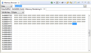

I'm seeing issue Fapi blank check bank1 sector 15 always returns not blank error (655539 or 0x09FFFF) reports 0x0A0000 but was never erased.
No matter what length is input for the total number if bytes in the sector only 0x0 length returns Fapi_Status_Success. Input length 1 less (0x000FFF) returns the same error.
So it returns Fapi_Status_Success and memory is indeed all FF's up to not including 0x00A0000 __.
A length of 0x000FEA or 0x001000-16 words returns the same not blank error, only on sector 15 it seems.
Is there something wrong in the call sector length?
Is this result of reading past the end of memory errata Advisory?

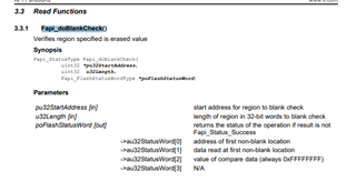

    Please see below snapshot taken from the F280049 flash API guide: https://www.ti.com/lit/pdf/spnu628
    u32Length should be in 32-bit words.

    The second parameter in below function call should be 0x800 and not 0x1000.  This function needs the number of 32-bit words that you want to check for blank status.
    oReturnCheck = Fapi_doBlankCheck((uint32 *)0x09F000, 0x001000, &oFlashStatusWord);
    Please try 0x800 and let us know how it goes.

    Your original question in this post is about blank check:  Sector 15 is the last sector and hence if the flash API reads the memory after the last address of the sector 15, it won't get valid data (and may not be blank).  Hence, I suggested to not send the length that crosses the last address of the bank.  For other sectors, even if you cross the sector end, there is still valid flash memory and hence it would work.
    Regarding 64-bit corrected data:  Each 64-bit aligned data has 8-bits of ECC.  When CPU does a fetch/read from any address in the flash, 128-bit (aligned) data + the corresponding 16-bit ECC will be returned.  This contains two sets of 64-bit data and their corresponding 8-bit ECC.  However, CPU will use only the required amount of data (code or data based on the opcode) from that 128-bits.
    Flash/RAM in the C28x devices are 16-bit addressed (address increments for every 16-bits) - Hence the TRM image shows 16-bit Flash.
    Regarding the remaining items that you discussed, I would like to discuss in a call to understand better.  Please let me know your convenient date/time.
    Thanks and regards,
    Vamsi
  • For other sectors, even if you cross the sector end, there is still valid flash memory and hence it would work.
