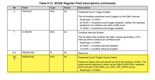

Why the function  DMA_configMode ()  for the c28379D is not working ?
the example below shows 2 deferent configurations but the PERINTSEL not set properly or even changing !!
  • Naim,
    Those are legacy bits that are no longer used on the F2837x device.  They have been replaced with the DMACHSRCSELn registers.  Please see below from page 673 of the TRM
    You will need to open a watch window to the SysCtrl Register space, base address shown here.
    Matthew
