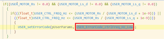

  • Hi Yanming,
    1. The error that the control frequency is too low:
    USER_ErrorCode_ctrlFreq_Hz_Low
    2. The Hall current sensor has a delay of several us, and the filter is a small capacitor.
    3. In addition, USER_CTRL_FREQ_HZ=9/45 * 1000000, which is 200KHz, can it be so large here?

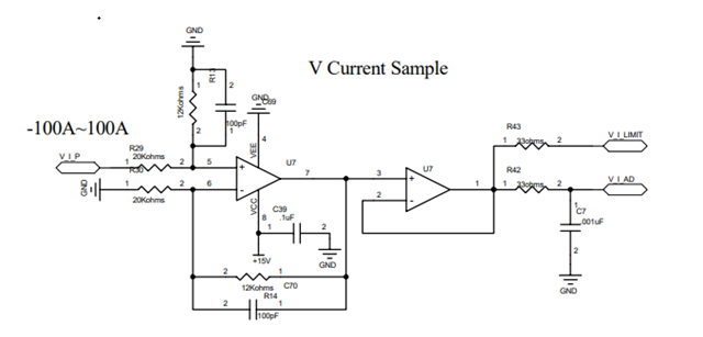

    4. The added signal conditioning circuit looks like this:
    1) V_1_P is the network label of the voltage signal output by the Hall current sensor.
    2) The capacitor C7 of the filter has a capacitance value of 10nF.
  • 3. In addition, USER_CTRL_FREQ_HZ=9/45 * 1000000, which is 200KHz, can it be so large here?
    Seems like the motor parameters are not correct. The Rs is too high and the Ls is too low. Check the motor datasheet to make sure that these values are correct.
    The delay is too large to run a high speed motor, low power motor.
    The capacitor could be changed to 1~2.2nF. And the hall sensor is suitable for a high current motor, not the low power low current motor.
