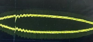

I am generating an AC waveform, but one exact PWM is missed during each period (100kHz is the switching frequency and 60 Hz is the AC period); has anyone faced the same problem.
Let me know if you need additional information regarding the waveform.

  • Thank you for the reply,
    here is the Code and the PWM waveforms that I get:
    The code and the pictures are attached:

  • Hi Payam,
    Code seems okay to me in terms of setting the ePWM.
    Can you commnet which ePWM module is missing the output? it might be due to logic error?
    and if this is happening for one time, double check on the ISR logic.
    Let me know if the problem still remains.
    Uttam
  • Thabk you Uttam,
    ePWM2 is missing the cycle; the out is an AC waveform and at each AC period and at the same moment that is shown by the yellow waveform, the ePWM2 is missing.
