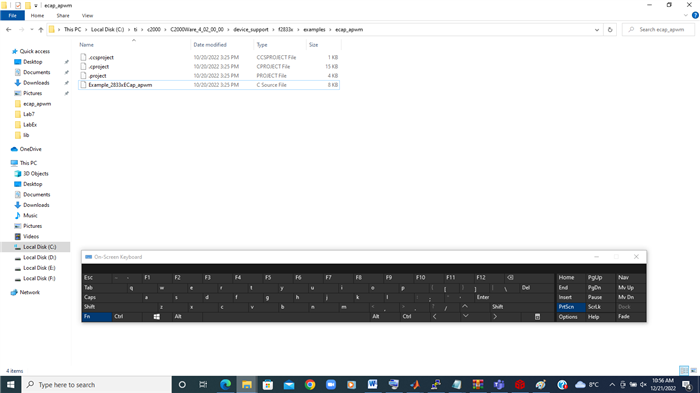

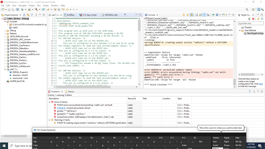

Example_2833xEcap_apwm doesn't work. Building Errors. Kindly check the console window. Please suggest

  • Hi Muhammad,
    I have tried and built this example and only got one warning. Here is my output log.
    Did you download the latest C2000WARE from here? (Under C:\ti\C2000Ware_4_02_00_00\device_support\f2833x\examples\ecap_apwm is where I imported the project)
    Ryan Ma
  • yes I have tried wih new version of C2000ware but it gives me same error. I copied the whole code of ecap_apwm from the same location in lab_7_1 file and then ran again for building but i gives me same error.  Please suggest

  • Hi Muhammad,
    It appears that you are missing the source file for this InitECapGpio() function. Looking at the project it's found here at this file DSP2833x_ECap.c
    Try and copying the contents of that file to your project.
    Ryan Ma
