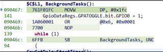

Using an oscilloscope, the GPIO-pin toggles at ~160ns. In the debugger (with the debugger-clock enabled), each function-cycle takes 15 clocks, which should be ~75ns at 200Mhz. Looking at the disassembly for these 4 instructions:
Should take 7 cycles, or ~35ns.
I expect some of this is the IO-ring propagation delay, but I could only find the stated GPIO rise/fall times at 8ns, which should not be relevant.
Can you tell me why there are 3 different timing data -- 4 instructions that should take 7 cycles (35ns), are shown in the debugger-clock as 15 cycles (75ns), but actually take ~160ns?
