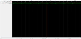

  • Hey Oren,
    I was able to import your syscfg into a project. Just so we can start from a common ground, I turned off HRPWM and viewed the waveforms on EPWM1A and EPWM2A.
    1. Disabled HRPWM support, I am getting a 50kHz signal, with them being in sync.
    2. Now I enabled HRPWM and view this. They seem to no longer be in sync
    Let me get back to you on why this is.
    Ryan Ma
  • Hi Oren,
    I believe I have found the cause of this issue. We will take care of this within SysConfig for the upcoming releases once we verify this. But what seems to be happening is when you enable HR support within SysConfig, SysConfig replaces this function
    EPWM_enablePhaseShiftLoad(Reset2_BASE);
    with
    HRPWM_enablePhaseShiftLoad(Reset2_BASE);
    However according to our TRM we have to set both TBPHSHRLOADE and PHSEN to be 1.
    So in order to fix this issue, make sure to call both of these functions to enable synchronization.
    Here is my syscfg file that uses your same settings, just in case you wanted to use it as reference for any checking. However please note that this is for the controlCARD.

    The solution work in terms of high-resolution phase shift. However, there is a jitter in obtained period.
    can you see it in your device?

  • Hi Oren,
    According to our TRM an EPWMxSYNC pulse will introduce +/- 1 - 2 cycle jitter to the PWM (+/- 1 cycle in up-count mode and +/- 2 cycle in up-down count mode). Is this what you are seeing?
