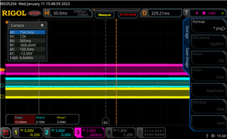

I'm trying to run proj_lab01b on custom hardware with  tms320f28069m. Actually I'm using LaunchPadXL with TMS320F28069M. I've loaded an example for hvkit_rev1p1.
I've configured USER_MOTOR == Dayton_2N865T, also I've have to add (because of errors in compilation)
#define USER_MOTOR_FREQ_LOW (5.0) // Hz - suggested to set to 10% of rated motor frequency
#define USER_MOTOR_FREQ_HIGH (50.0) // Hz - suggested to set to 100% of rated motor frequency
#define USER_MOTOR_FREQ_MAX (60.0) // Hz - suggested to set to 120% of rated motor frequency
#define USER_MOTOR_VOLT_MIN (40.0) // Volt - suggested to set to ~20% of rated motor voltage
#define USER_MOTOR_VOLT_MAX (220.0) // Volt - suggested to set to 100% of rated motor voltage
gDacData.ptrData[0] = &angle_gen.Angle_pu;
gDacData.ptrData[1] = &gPwmData.Tabc.value[0];
gDacData.ptrData[2] = &gAdcData.I.value[0];
gDacData.ptrData[3] = &gAdcData.V.value[0];
pDacData->offset[0] = _IQ(0.0);
pDacData->offset[1] = _IQ(0.5);
pDacData->offset[2] = _IQ(0.5);
pDacData->offset[3] = _IQ(0.5);
pDacData->gain[0] = _IQ(1.0);
pDacData->gain[1] = _IQ(1.0);
pDacData->gain[2] = _IQ(1.0);
pDacData->gain[3] = _IQ(1.0);
The problem when I'm running this project,  I get this:
CH1  - Angle_pu CH2 - Tabc.value[0]
Is this correct?

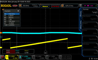

I've tried to run proj_lab01b for another board  - drv8312kit_revD.  It needed some changes to run with parameters for ACIM motor, and then I can see a normal graph for angle
Can you tell me what is wrong?

  • Hi Andrey,
    Are you using a specific example within ControlSUITE? If so, which one (provide directory if possible)?
    Hardware wise you mention using the F28069 LaunchPad, but the HV kit solutions are meant to be run with different hardware (i.e. ControlCARD + HV system kit, like TMDSHVMTRINSPIN).
    Is this correct?
    Does the motor spin properly and smoothly when running the projects? The first waveform showing the angle does not look correct, it should be linear like the 2nd waveform for a consistent motor speed/direction.
    Kevin

  • Hello and thanks for answer.
    Now I've checked everything again and found out some strange things.
    Tests 1, 2 performed on LaunchPadXL TMS320F28069M
    1. I've imported proj_lab01b from C:\ti\motorware\motorware_1_01_00_18\sw\solutions\instaspin_foc\boards\hvkit_rev1p1\f28x\f2806xF
    Then I've changed motor type to Marathon_5K33GN2A, also I've added for this motor, to avoid errors in compilation.
    Then I've compiled it, started debug and set gMotorVars.Flag_enableSys and gMotorVars.Flag_Run_Identify.
    Here is wavefroms from main owm outputs (no sin like pwm signals, but only modulation frequency)
    2. I've imported proj_lab01b from C:\ti\motorware\motorware_1_01_00_18\sw\solutions\instaspin_foc\boards\drv8312kit_revD\f28x\f2806xF
    selected the same motor and run. (also I have to bypass user_params check, because I've got USER_ErrorCode_ctrlFreq_Hz_High error, don't know why).
    Now I get correct pwm signals.
    3. I've migrated to my custom hardware, based on  TMS320F28069M, (have to add some code, for IGBT_EN signal control at startup) and tried to run small 0,55kW  380V motor. For safety reasons, I've applied only 30V DC power supply for IGBT. And now the motor runs normally at low speed. I have not controlled current and voltage waveforms yet.
    So, I don't know what is wrong with proj_lab01b from C:\ti\motorware\motorware_1_01_00_18\sw\solutions\instaspin_foc\boards\hvkit_rev1p1\f28x\f2806xF but it seems it's not working correctly.
  • Hi Andrey,
    There are quite a few differences in the parameters found in the user.h files of these two projects. If you're using the same hardware and motor for both projects there may be some parameter values you need to change in the user.h file of the hvkit_rev1p1 project. I'd suggest using a compare tool to compare the user.h files of the two projects to help identify any parameters that should be changed.
    I'd also suggest verifying some variables other than the angle using the PWMDAC and DATALOG modules, like the sensing variables.
    Kevin
