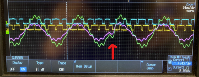

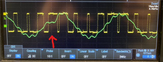

Once the DMA has been introduced, my sine output shape is being affected due to EXTSYNC1.

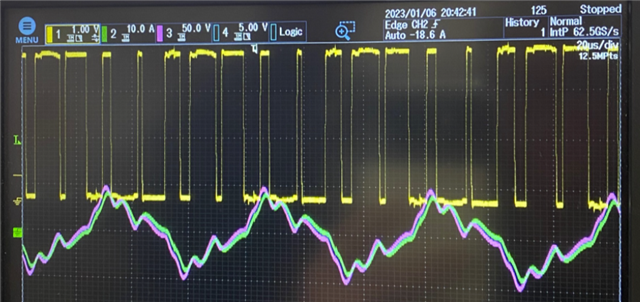

In other words, when I have EPWM_enablePhaseShiftLoad(EPWM1_BASE); line in the code, which uses EXTSYNC1 to load TBPHS (Phase Count = 0) into TBCTR. My sine wave output is distorted as shown below
My ideal output looks like below

    There were random changes in SPWM outputs that were causing my final sine wave to become distorted.
    Please see some of the scenarios below. This issue was resolved once DMA was added for updating the CMPA register (initially this was done in EPWM ISR). The image with 2 EPWMs are EPWM 1A and 2B, and the instance at which there is an issue with the sine wave I see that both 1A and 2B are ON momentarily, which is not the case for other normal sine waves.
    Rashmitha
