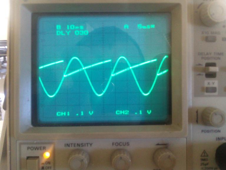

  • Dear Manish,
    I totally agree with you, but the result is not sinusoidal.
    My code is the follow:
    theta = (long)((long)(spll1.theta[0])>>3)-_IQ15(phase_diff);
    sen_theta = _IQ15sin(theta);
    Can you help me?
    Thank you for your kindness!

  • Dear Manish,
    Thank you very much for your patience.
    I have include your 3414.SPLL_1ph.h, and my snippet code is:
    SPLL_1ph_run(&spll1);
    Vac_in=(long)((long)AdcResult.ADCRESULT1<<9)-Offset_Volt;
    spll1.AC_input=Vac_in>>1;
    InvSine = (long)(spll1.sin[0])>>6; // InvSine is in Q15
    theta = (long)((long)(spll1.theta[0])>>6)+_IQ15(phase_diff); //theta is in Q15
    The result is show in the following picture:
    Where the sinusoidal wave is InvSine (fully locked with the grid wave), and the sawtooth wave is sen_theta!
    certainly made ​​a mistake, I will be grateful if you can help!
    Thanks Reguards
  • Please Someone reply!
  • Correction to your code
    You should update your Vac value before calling the PLL,
    I guess the theta locks,You should try out a few things and understand how to get the value shifted by theta,
