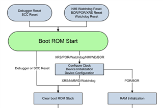

I'm having a weird issue with CAN 0 on the F280025 (80 pin if it makes a difference).
If the processor is powered up normally (ie. 3.3V applied).  It seems to send CAN messages just fine, but cannot receive anything.  If I reset the processor (pulling XRSn low) then it works (or if I hold XRSn low during startup).  Everything else seems to work just fine (boots properly from flash, pwms work, adcs function, etc..).  When running off a debugger, I never have the issue (I would guess because it toggles the XRSn).
I'm using all the recommended practices for XRSn and 3.3 comes up very fast and is super stable.
I can properly detect that I'm not receiving and trying to re-init the CAN0 and it doesn't help. Only pulling XRSn low works.  I've also tried using the simulated XRSn to reset the processor on startup... that didn't work either...
I haven't had this issue on F280049 or other C2000 processors.  Any thoughts on how to fix this?
  • Hi Kyle,
    This is probably a tart up issue and not at all related to CAN based on the behavior that you just described.  When not running off the debugger, can you scope the xRSN pin to see if there are periodic toggles?  Also please refer to below boot flow diagram snippet from the TRM:
    There is a different flow when started from debugger an and POR/xRSN reset/etc...  One of the first things to check is to see if watchdog is disabled if you are not using it or if you are, that it is serviced otherwise there would be periodic reset that you can observe on the XRSN pin.
    Joseph
  • I've scoped the XRSn pin versus the 3.3V, it follows with about 1ms delay, then is rock solid (no glitches).
    I am using the watchdog (pretty long delay on it), but I can confirm that it's not triggering as all the other systems are up and running and I have a run time counter that is still counting up without resetting.  We'll try turning it off to see if makes a difference.  Let you know soon.
    We did find one other method of getting it to work... holding the XRSn pin low while powering up, then releasing (use of a button).  Tried making the pull up resistor larger to slow down the bring up of this pin, but it still resulted in the CAN receive issue.
  • Hi Kyle,
    Any further findings with the WD being turned off?  By the way in your start up flow, did you ensure that CAN initialization is one of the first routines to be performed?  Maybe code is branching off earlier and bypassed CAN initialization routines.
    Joseph
  • Tried WD off... no help.  Same behavior..
    CAN is being initialized... Again, I am seeing transmissions from the board, just not receiving anything.  Plus, if it hasn't received anything for 4 seconds it forces a re-init.
    I thought maybe since CAN timing is pretty precise, it might be the crystal is not calibrating accurately enough for CAN to work properly.  That wasn't it either.
    I used a 200kHz PWM to see if the timing is any different.  It's not.
    I tried the internal oscillatorjust to see and it's 200kHz timing showed up as 202.5kHz, which is expected to not be perfect.  But, CAN had the same behavior.  Wouldn't work without manually pressing the reset button on the board... It did work even with the timing being off too.
