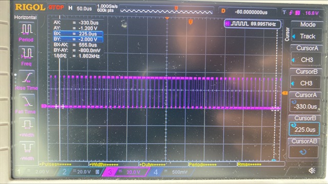

  • Hi ,
    Thanks for your reply, I have been able to implement it but the SPWM generated is not having the expected frequency.
    I have below lines for EPWM INT enabling.
    EPWM_enableInterrupt(EPWM1_BASE);
    EPWM_setInterruptSource(EPWM1_BASE, EPWM_INT_TBCTR_ZERO_OR_PERIOD);
    EPWM_setInterruptEventCount(EPWM1_BASE, 1);
    And below lines for enabling CLA INT based on EPWM 1 as trigger source

        CLA_setTriggerSource(CLA_TASK_1, CLA_TRIGGER_EPWM1INT);
    Other values for my EPWM generation are as below,
    TBPRD = 1112;
    T(TBCLK) = 1/200MHz;
    F(PWM) = 90kHz
    Before using CLA, my output was 18kHz when measuring 5 samples.
    Now, even though I am using EPWM1 as trigger source for CLA, the sine shape gets completed in 50 samples as shown below.
    Below is the calculation that I moved from EPWM1 ISR to CLA Task
    FLOAT32 sineTable_x1[10] = { 3.0, 8.0, 10.0, 8.0, 3.0, -3.0, -8.0, -10.0, -8.0,
                                 -3.0 };
    FLOAT32 sineTable_x2[10] = { -3.0, -8.0, -10.0, -8.0, -3.0, 3.0, 8.0, 10.0, 8.0,
                                 3.0 };
    __interrupt void Cla1Task1(void)
        EPwm1Regs.CMPA.bit.CMPA = (U16) (0.5 * (1112 + 75 * sineTable_x1[index]));
        EPwm2Regs.CMPA.bit.CMPA = (U16) (0.5 * (1112 + 75 * sineTable_x2[index]));
        index = (index + 1) % 10;
     It looks like the CLA isn't triggered for every trigger of EPWM1 INT. Please suggest what could be causing this and how it can be resolved.
    When I put an LED toggle in EPWM1 ISR and cla1Isr1(), I see that EPWM ISR's frequency is 180kHz and CLA ISR's frequency is 18kHz.
    Rashmitha

  • Hi ,
    I was able to drive the GPIO from CLA task by changing its Master Core to CPU1_CLA1 using
    GPIO_setMasterCore(31, GPIO_CORE_CPU1_CLA1);
    and I see that my computation lines are only taking 280 ns, whereas my EPWM triggers are every 5.5 us.
    But the final EPWM output is still not the way I get while using EPWM interrupts.
    I still have the EPWM 1 ISR defined just to acknowledge the event trigger and interrupt ack. I tried to move these lines to CLA Task and that runs me into some other errors.
    __interrupt void EPWM_1_ISR(void)
        EPWM_clearEventTriggerInterruptFlag(EPWM1_BASE);
        Interrupt_clearACKGroup(INTERRUPT_ACK_GROUP3);
    Edit:
    Moving those 2 lines of calculation(for CMPA values) into the CLA 1 ISR1 gives me the expected output (like how EPWM ISR gives). Any reason why CLA task and CLA ISR behaves differently? Please see the images below to see how the TASK and ISR give different outputs.
    Question: Does CLA1 ISR1 run independently/parallel to the C28x CPU?
    Output when using CLA Task:
    Output when using CLA ISR:
    Rashmitha
  • Hi ,
    I identified the issue.
    The problem was using % Modulo for computing the index variable inside CLA task.
    I changed it to a simple increment and and if loop to reset it to zero on reaching array size and it is giving the expected output.
