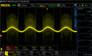

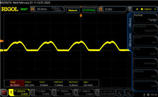

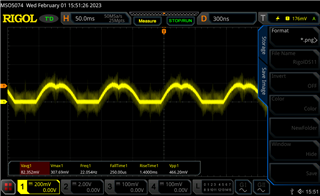

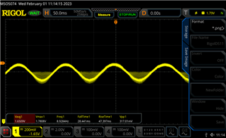

I compared now the inphase and the lowside signals for current and voltage measurement, and both look pretty descent and the same (around 4A at a motor speed of 10Hz):
Low Side Current:
Low Side Phase Voltage:
Inphase Current:
Inphase Phase Voltage:
So the only thing that goes into the observer are the current and voltage signals, so the error has to be there. I could not find any software or hardware influence on this behaviour. The only thing I do different in software is, that I need to invert the currents after the measurement for proper functionality on the low side hardware:

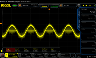

Edit2:
I tested the same software with a BOOSTXL-DRV8323RH, which seems to give the same performance as the Inphase system in terms of estimator. The signals look the same as on the other boards, so I am pretty sure it has something to do with the inverted current measurement I have from the amplifier:
Va EVAL Board, same settings as above:
Ia EVAL Board with the same settings as above:
Edit3:
I could solve the problem, there was a wrong value placed on the boards. What I would like to know now is only, how I could make the estimator keep the last position longer at low speeds without drifting away too fast.
