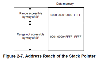

    The portBYTE_ALIGNMENT is defined as 2. This is to ensure the stack address is an odd value.
    And we use DATA_SECTION to keep it in a separate section so that we can allocate this to an address in the range 0-0xFFFF. This is because the C28x Stack pointer is 16 bit and hence the stack memories should be within 0-0xFFFF range. Other data/bss sections can go to the addresses outside this region

    What do you mean the C28x Stack pointer is 16 bit? I am a bit confused now.

    Regarding DATA_SECTION addition, its just for the C28x CMU? Why it should be a dedicated section? Is it a freertos or CMU requirement?

  • Yes, it is specific to C28x core. The C28x Stack pointer registers is 16 bit long. Hence stack memory should be in the range 0-0xFFFF. We ensure this by keeping the stack memories in a separate section and allocate them to this memory region in the linker cmd file
    Note that this is only in case data is accessed using stack pointer. The other data / bss section can reside in other memory ranges.

    You can very well remove it and add memory regions (or combined memory regions) as needed. You need to make sure that the region does not cross the 0xFFFF boundary.
