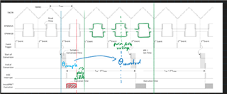

I would like to use the formula below, what do you think of that? (PWM_TICK_PER_ISR = 1) Because of the delay from the PWM duty cycle update, I must add one PWM cycle as an angle delay. Here I’m not 100% sure, but I would add another half of PWM to get to the average PWM voltage, is this a good idea? (Like in the first picture below). The other option would be to set the corrected angle on the beginning of the PWM period. What is better?
My formula would look like this:
 angleDelta_rad = Freq_hz_motor * 2pi * PWM_ticks_per_ISR/ PWM_freq * ( 1 + 0.5 ) (in rad)
PWM_ticks_per_ISR = 1 -> angleDelta_rad = 0.2355rad -> 13.5°
PWM_ticks_per_ISR = 3 -> angleDelta_rad = 0.7068rad -> 40.5°

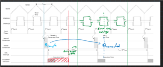

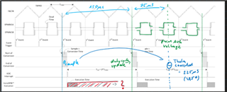

Here is a picture, first PWM ticks = 1 and the second picture PWM ticks = 3:
The same but  PWM_ticks_per_ISR = 3.
Here I add three pwm cycles and the half of three for the average voltage.

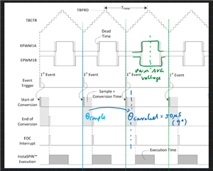

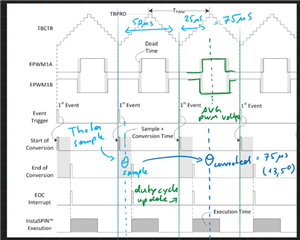

I also drew  the sample angles and the corrected angles  for the calculations in the examples.
Picture for motorware:
mcsdk Instaspin-foc for 280049c :
sensored foc CAN drive:
But I also not sure if PWM_ticks_per_ISR = 3, when the PWM duty cycle gets updated. If the duty cycle gets updated after the three PWM cycles, then my formula for PWM_ticks_per_ISR = 3 should be ok. If this is not the case and the PWM value gets updated, whenever the FAST Estimator is finished and writes the PWM values in the CMPA, then I must overthink my formula for PWM_ticks_per_ISR = 3. (I think I would have to consider the execution time in relation to the PWM frequency). Like the picture below:
When is the PWM duty cycle updated?
(But as mentioned above I’m not 100% sure if I should set the corrected angle in the middle of the PWM period)
    That depends on the PWM configuration. By default, the PWM duty will be update when the PWM timer counter equals to zero.
