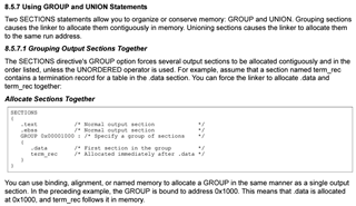

In a linker command file, is it possible to create a union of groups? If so, would you please steer me to the appropriate documentation?

Hi Ed,
Please refer to C2000 Compiler document.
https://www.ti.com/lit/pdf/SPRU513Y
