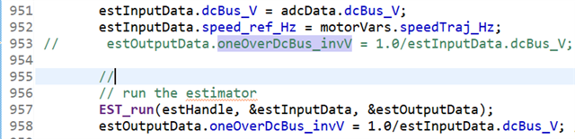

I'm debugging the motor control with TMDSHVMTRINSPIN in C2000Ware_MotorControl_SDK_4_00_00_00. However, there is an wired issue in lab4 (current close loop). The code's location will influence the value of oneOverDcBus_invV, which will jump between a very big vlue and 1/Vbus.  Further, the CMPA‘s value will not a constant value anymore. If I place this code to from line953 to line958, this issue will disappear. So is there any potential issue for the EST and the next labs? Why is like that?

  • I'm attaching the pictures about the question1, the value jumps between 0.11 and 31415.
  • Please monitor the "adcData.dcBus_V", seems like the issue could be from the dc bus voltage sampling value.

    See the following pitures:
    I have added breakpoints and run step into. The value"estOutputData.oneOverDcBus_invV" will change once run this code "EST_run(estHandle, &estInputData, &estOutputData)". Also, this issue disappear if I place the " estOutputData.oneOverDcBus_invV = 1.0/estInputData.dcBus_V" after the EST_run function. So I doubt if there any initialization or something in the black box. Would you please check this code?  In addition, why we give a constant value to a output register, instead of output it from the EST?
    I have also read the code of universal_motorcontrol lab, there is no assignment statement to "estOutputData.oneOverDcBus_invV". Just a comparision.
    About the question about lab5, hope your comments too. Thanks!
  • If you don't change anything in the original example, the estOutputData.oneOverDcBus_invV will be calculated by calling EST_run() in lab05 and the following labs.
