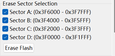

1) Encryption generally succeeds when the TMS320f28027F is encrypted with the CCS11.2 version. However, the following reminder appears when decrypting, "Device unlocked. To clear the programd password, please erase sector A of Flash memory. " While Node A has chosen to erase, is it necessary to be under wait in bootload to unlock when decryption?

              The correct term we want to use is “securing”, not “encryption”, since we are not encrypting the code but securing the memory from unauthorized access.

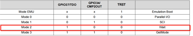

    No. The "Wait" bootmode is used only during power-up. It is useful to keep the device looping in boot-ROM and not access the flash, which is a secure resource. If the flash is accessed in a secure device, it would trigger the ECSL logic and break the debugger connection. To summarize, the "Wait" bootmode is not relevant during Erase/Program operation of the the Flash.

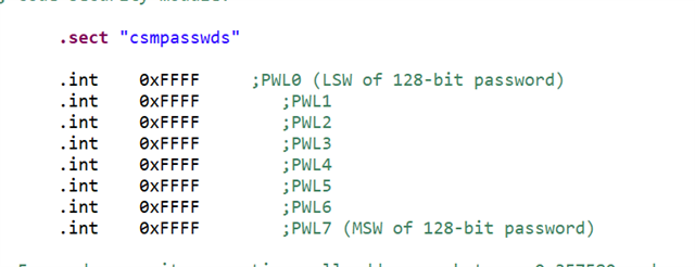

    3) Adding the file _CSMpasswords.ASM, encrypting as a file, can the CCS on-chip flash password be emulated if the same password is used?
    I presume what you are asking is whether passwords can be added using the CCS on-chip flash programmer the same way we add them to a project using _csmpasswords.asm. If so, the answer is “yes”.

    The program may not run without an emulator since it is under Wait in Bootload mode or because the address of CodeStartBranch.ASM is affected. May I know is there any possible cause other than the above two possibilities?
    The "Wait" bootmode should not be used under normal circumstances. To boot from Flash in standalone mode, only GetMode should be used.

    When the f2802x_csmppasswords.ASM file is added, the program cannot run without modifying the password. However, if the password is modified, the emulator program will not run if it is re-flashed.

    Please let me specify more on the case:
    The customer added the f2802x_csmppasswords.ASM file to the project of the program in use,  according to the customer's understanding, the essence of this file is to write the appropriate password to CSM, that is, to the corresponding address(CSM_PWL_P0 : origin = 0x3F7FF8, length = 0x000008 ). However, during actual debugging, when the file is added and 0xffff is written to all addresses, the program starts normally without the emulator. However, when changing this address to the password written by the customer, the program cannot be started without an emulator. That is, after changing the address from 0x3F7FF8 to 0x3F7FFF, the program cannot start. However, according to the 28027 guide, the address of the CSM is 8 of these bits.
    Addresses 0x3F7FF8 through 0x3F7FFF should not be accessed when getmode() is started directly when the chip is powered on. If not, why does the program fail to start at power up?

  • Cherry,
              As clarified earlier, security does not impact code execution. I also pointed customer to an e2e post that discusses why code may not run without emulator. There is something the customer is doing which we are unaware of. This is a very old module (almost 20 years old) and is fairly straightforward to understand, compared to DCSM. Please have customer try a simple GPIO toggling code with security, as opposed to their project. They can also examine their .map file for correct placement of DSP2803x_CodeStartBranch.asm and the passwords. Sorry I am unable to help.
