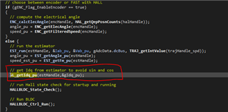

I’ve read several posts that say it is not possible to use the fpu32 in LAB11 (a,b,c,e) because of the EST_getIdq_pu.lib.
I saw some who used a PARK function instead of EST_getIdq_pu but I don’t want to the that because the estimator already calculates it.
I read somewhere where Yanming said to put the float calculations in a separate file and set the compiler option to fpu32.
Is it possible to put the EST_getIdq_pu() function in a separate c file and call it like that?
And set the c file which contains the EST_getIdq_pu() to softlib.
When I try this, I get several error e.g. :
Output from building with the different math options:
I think it's not possible?
I have a few float operations and don’t want to do it with the IQmath. If there is no other option, I will do it with the fixed-point math.
