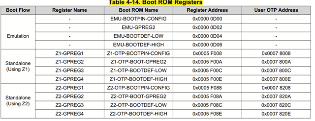

So I tried to write on address 0x78008 --> 0x5AFFFF20 so that it boots only dependent on GPIO32. And in 0x7800C --> 0x00000C23. First option is to boot from flash at address 0x88000, second is to flash from SPI.
I am not able to write to the OTP. I tried adding this in the code, but I could not make it compile properly with the FAPI code. Then I tried adding it to the linker file, but it does not get flashed. I can see the data at this address in the "out" file (actually checking it in the s19 file that is generated by hex2000), but if I flash with XDS110 this image and then check with the "memory browser" I see only 0xFF at this addresses. Then I tried the same thing with Uniflash, again it did not succeed. Then I tried both in CCS and Uniflash to manually write these registers as seen below.

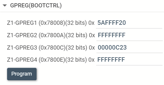

    To write to OTP you can direct initialized global variables pointing to 0x78008 and 7800C. and then load the program via CCS. The flash plugin in CCS will take care to program the OTP values. After loading you need not run the program, just loading will do.
    Alternatively you can make use of the exmaple project at C2000ware \c2000\C2000Ware_4_03_00_00\driverlib\f28003x\examples\dcsm
    Open the sysconfig tool and make necessary changes to OTP value, compile and load the program.

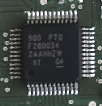

  • I think i have the same problem. We have custom boards with the TMS320f280034 (48pin) and controlcards with docing station having the TMS320f280039C (100 pin).
    If we want to program the custom boards we get the same error as above. It happens for Z1 and Z2 OTP
    C28xx_CPU1: Error during Flash programming (Flash algorithm returned error code 0x00000000, FMSTAT (STATCMD on some devices) 0x00000000). Operation cancelled.
    The TMS320f280039C can be programmed correctly. We also tried to flash the TMS320f280039C a second time and the shown error does not match the error of the TMS320f280034.
    C28xx_CPU1: Error during Flash Programming. Address 0x00078008, FMSTAT (STATCMD on some devices) 0x00000030
    The OTPs we want to write are
    Z1OTP 1 0x5AFFFFFF
    Z1OTP 2 0x5AFFFFEF
    Z1OTP 3 0xFFFFFF23

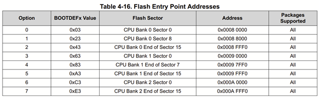

          .long 0x5AFFFF20     ;Z1OTP_GPREG1 = Z1_BOOTPIN
          .long 0x5AFFFFff     ;Z1OTP_GPREG2
          .long 0xFFFF0623     ;Z1OTP_GPREG3 = Z1OTP_BOOTDEF_LOW
          .long 0xFFFFFFFF     ;Z1OTP_GPREG4 = Z1OTP_BOOTDEF_HIGH

  • Hi Joao,
    Could you please attach a snapshot of the F280034 device that you are using?
    Thanks and regards,
    Vamsi
  • Hi Vamsi,
    what do you mean with snapshot? a photo of the physical componnet? or a snapshot of the memory? or something else?
    best regards
  • Hi Joao,
    Please send a photo of the physical component.
    Thanks and regards,
    Vamsi

  • Hi Vamsi,
    this is the image of hte component as promised.
    Yes, the issue is solved. Just to have it written for others that could face this issue, I tried only with variables that are positioned in this specified addressed by the linker file, i.e. they are present in the map file and of course in the out file and then I flash the out file with the debugger via CCS and the OTP memory is updated. I wanted to try also through CCS, and than I was about to write back here, but since you wrote now, I can confirm that this update fixes the issue. Thank you for your support. Please, close this topic.
    best regards
