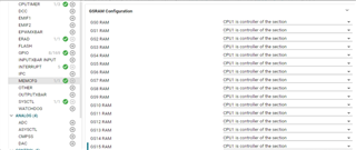

Hi Team,
There's an issue from the customer need your help:
As show in picture one, GSRAM all is controlled by CPU1.
In picture two combined GS9-15 RAM to GSRAMB and it has generate CMD file in the right side of picture.
In picture three if I allocate GSRAMB to data section, it will shows the error 'The memcfg module is needed on CPU1 to assign GSRAM', and it will shows whichever section I allocate. Is this a bug?
I use the latest C2000Ware and sysconfig.
Could you help check this case?
Thanks & Regards,
Ben
  • I believe it is a bug. I am able to reproduce the issue. I will file a ticket to get this fixed in the next C2000ware release.
    Veena
  • I see this bug too.
    Can you please provide link to the ticket in jira?
    I can add that is seems to be correlated with using memory combinations, ion my small example i just added all gs ram sectors to a combination named RAM_GS. And i got the error as described by Ben (exept i saw it on bss section).
    I fiddled around with it, an found if I removed one sector from this combination, and then select the build-in symbol RAMGS15 that now shows on the pulldown list. The error goes away.
    resulting in this cmd file
