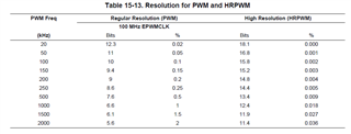

    If you are trying to have a range from 40Hz - 20kHz and assuming you are running at SYSCLK 200Mhz, your EPWM clock (EPWMCLKDIV = /2) will be 100Mhz.
    Assuming in up-down count mode to achieve this wide range you can enable HRPWM when you're running at 20kHz and then disable HRPWM when running at the lower frequency range.
    I would suggest to have your CLKDIV = /4, and your HSPCLKDIV = /6. Thus giving you a /24. Your max TBPRD when running at 40Hz would be 52083 and your TBPRD at 20kHz would be 104. HRPWM will allow you to have a higher resolution at 20kHz when you enable it, Right now your resolution at 20Khz without HRPWM would be ~6 bits but enabling HRPWM you can achieve higher bits of resolution.
