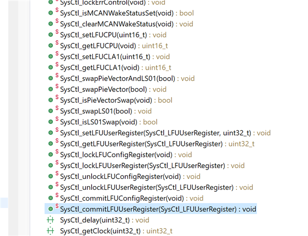

Questions:
1. Should the user copy all these functions? Are there equivalent driverlib APIs for these? If not, can we add them in the driverlib?
  • Wayne,
    Most of the LFU function shown here are now supported in sysctl.h and hw_sysctl.h files in driverlib. It should be straight forward to migrate these. Let us know if there are any specific functions pertaining to LFU that are still missing.
    Ozino
  • Wayne, Ozino,
    Correct, I had made a note of this in my notes, since back then C2000Ware didn’t have these functions supported, so I had to add and include them into our solution.
    So yes, we can (and will need to) leverage the C2000Ware functions directly, and remove them from the solution. If there are any differences, we will need to get them supported in Driverlib.
    Off the top of my head, I think there was one function I created – which sets (or clears) both the PIE swap and RAM swap together. I don’t believe we have this in Driverlib.
    Sira
  • Dear Ozino, Sira,
    I checked the latest C2000ware V4.03 driverlib.
    I do see PIE and LS0/LS1 swap related API.
    But it seems there is no "Shadow_Interrupt_register(uint32_t interruptNumber, void (*handler)(void))", which is needed and useful for LFU.
    Do you see it?
    Wayne
  • Wayne, Ozino,
    I agree this will be useful as well.
    - LFU_Get/SetSwap()
    - Shadow_Interrupt_Register()
    Sira
