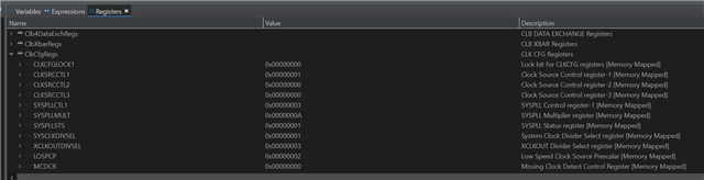

    Any idea how the GEL file can include SYSCTL registers missing in the XDC110 x49c simulators?
  • GI,
             We have shipped tens of millions of these devices since it was released to production over 5 years ago. This device is used in many applications where it is subject to many PORs in its lifespan. There are no known issues for this device to work in low-speed either. Also, because of the PLL issue, the POR behavior has been tested fairly extensively. As mentioned before, it is unlikely this is a device issue. Our ability to support/debug deep software issues on your side is very limited.
    You can get visibility to all SYSCTL registers using View-->Registers
    The SYSCTL registers used to set the OSCCCLK are not where anyone would expect them to be located, per C2000 driverlib HWREG calls. You don't see a problem of listing SYSCTL registers right under CLB then inside CLKCFG, they are located under SysCtrlRegs in other TI MCU classes. Like putting some system control registers under CPU name when they have nothing to do with the CPU registers as all are peripheral control registers. Name conventions in C2000 GEL files are confusing do not have register names that would be expected as elaborated in TRM text. Obviously my bad for expecting consistency between various MCU classes naming conventions.
    Example: The RESCAUS register is listed under CPU when it is a SYSCTL register for watchdog reset condition in TM4C listed under registers. Seemingly whoever designed the debug simulator GEL file has never viewed other TI MCU classes. So it's a bit upsetting when trying to get things done, like when you know you put car keys where always do but are not there and they're in your pocket all along Joy.

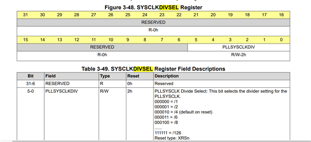

    Regarding the value of PLLSYSCLKDIV in register view, the input values for dividers can be 1 or even values upto 126.
    We are storing the /2 of the input divider value in the register.
    As per the TRM, when the divider value is 2, PLLSYSCLKDIV holds the value 000001.

    So the resulting PLL speed is 10x20MHz or (PLL=200Mhz/2) and PLL XCLKOUTDIV (0x3)  000011=/8 results in 12.5MHz SYSCLK speed? I was under the impression SYSCLK speed was 100MHz. Perhaps could also explain random OVFLO issues from SCIRX FIFO even from few as 4 words.
    Interestingly PLL XCLKOUTDIV on reset (/8) would produce a 12.5MHz SYSCLK? So 12.5MHz SYSCLK is the (SW reset) application speed after firmware loads? And SYSCLK of 12.5MHz is POR speed after the application asserts the clock configuration code? Some logical deduction has to explain the difference between POR and SW reset events making the application behave differently in either clock mode. Seemingly 100MHz SYSCLK results in better MCU application performance with fewer issues.
    From the description in the thread, it is mentioned that the clock configuration is -
    SysCtl_setClock(SYSCTL_OSCSRC_XTAL |
    SYSCTL_IMULT(10) |
    SYSCTL_FMULT_NONE |
    SYSCTL_SYSDIV(2) |
    SYSCTL_PLL_ENABLE);
    So from the configuration, the resulting SYSCLK speed is -
    PLLSYSCLK =  20MHz (XTAL_OSC) * 10 (IMULT) /  2 (SYSDIV) = 100MHz
    Even we are storing SYSDIV/2 into the register field, in effect it takes the actual SYSDIV value.
