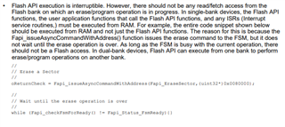

customer wants to call the Flash API from ROM. Does the user application (customer boot loader) function be copied to RAM for calling the Flash API if they program the same flash bank? Why?
I know it is written in the Flash API:
"In single-bank devices, the Flash API functions, the user application functions that call the Flash API functions, and any ISRs (Interrupt service routines,) must be executed from RAM."
