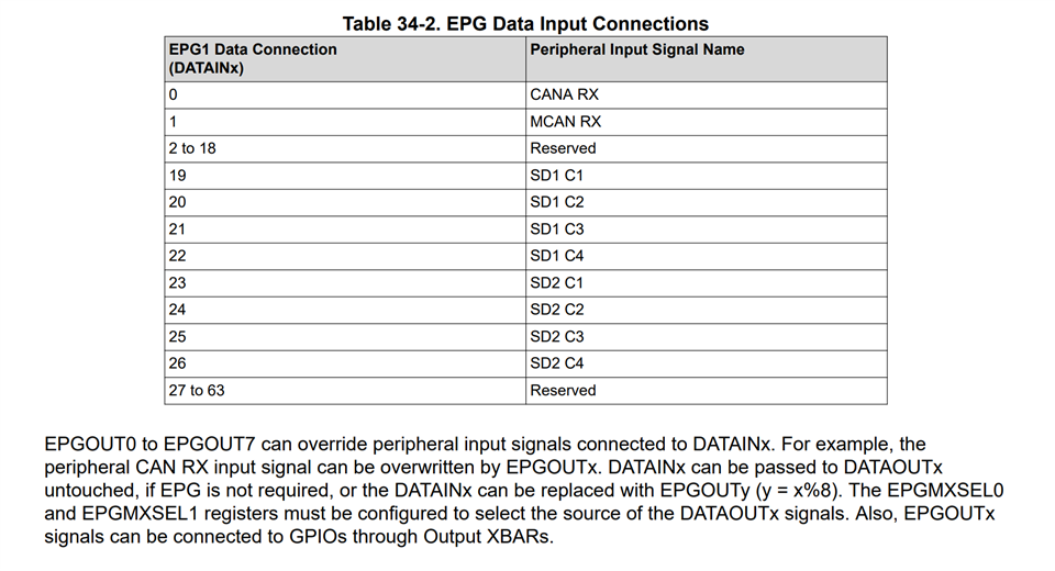

TMS320F280039C: How EPG Dataout used
Part Number: TMS320F280039C
How is TI 0039 EPG Dataout used?
As description of 34-1.
The document describes that Dataout is connected to the input signals of other peripherals, but the document does not specify which peripherals are specifically connected to the input signals。
