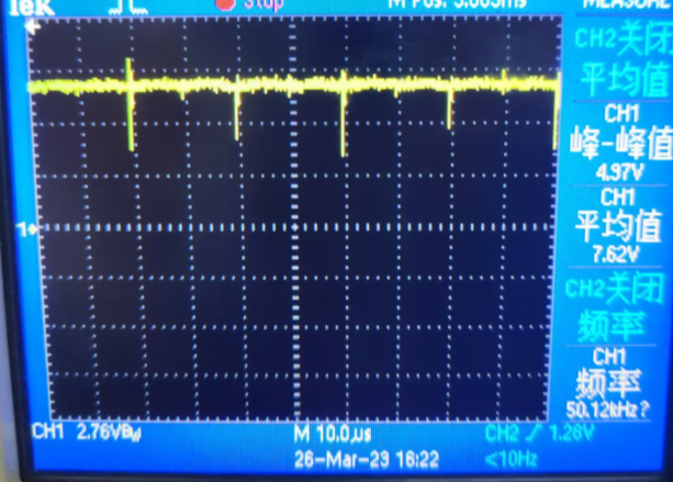

Project: Flying capacitor type three-level buck circuit.
The customer uses the 28379D launchpad to do a single voltage closed loop (flying capacitor voltage balance is not yet controlled) where the output voltage starts to drop after the input reaches above 20V. The assumptions are as follows:
1) The isolated amplifier + normal op amp conditioning circuit is selected for sampling and has been tested with a stable DC voltage without problems.
2) With a custom board, the same voltage is output at different duty cycles in open loop (e.g. 20V output 8V, 30V output 8V), the output voltage of the sampling circuit is higher with a multimeter at high voltage input, and the same data is obtained when checking the monolithic unit at the computer side.
3) The problem persists after replacing the power plate to plate wiring with shielding and trying to reduce interference.
4) The following are the waveforms of the output voltage at an input of approximately 30V:
Based on points 3) and 4), the customer assumes that the output voltage effective value is higher due to the shut-off spike of the output voltage at high voltage, so the sampling value of the monolithic machine is higher and the duty cycle of the control switch is reduced. So the following changes were made:
The switching frequency is 50 kHz. Sampling Frequency = Switching Frequency, the problem persists after trying to avoid spikes by modifying the sampling point to 3/4 of the switching period.

Customers want to try to reduce the shutdown spike by adding RC snubber to see if the problem can improve, but MOS package and board layout do not allow it.

  • Hi Cherry,
    Is it about the the timing of ADC sensing?  If so, we normally sense voltage at EPWM Period/Zero to avoid switching noise.
    The output voltage waveform does not look good with the spikes. Not sure about the spike magnitude, but you may want to ask customers to check the hardware design.
    Qing
