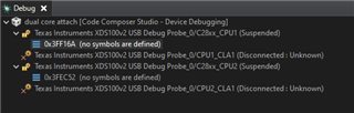

I am trying to create a CCS Debug Configuration that only attaches to currently running code by loading symbols only. Even though I create a debug configuration that loads symbols only, the processors apprear to be reset and in an IDLE loop of some kind.
How do I create a debug config that attaches to one or more cores in the C2000 chip?
