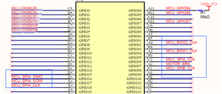

I am recently developing the CLB module of DSP28388D and need CLB to complete the decoding of two BISS signals, but I only see the CLB routines of DSP28379D on the Internet.
How can I find the CLB development for this block of DSP28388D and can the source code be applied? Thanks!

    For development with CLB, the preferred method of configuring the CLB module is to make use of the CLB tool integrated in the SysConfig application. More information about it can be found in our CLB Tool user guide ( https://ti.com/lit/spruir8 ). It does not have have dedicated input pins. Instead, signals are routed to the CLB either through INPUTXBARs or directly from other device modules if they are present on the CLB input mux (refer to the device TRM for these specific signals. I will let my colleague comment on availability of this BiSS-C decoding support on F28388D device
    Peter
    Currently we do not have plans to port our BiSS-C example library to work on F28388x.
