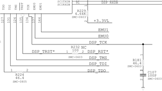

    This issue can be caused by a number of things, including some pins not being connected between the JTAG debug probe and the MCU. If you have access to an oscilloscope, could you try probing TDO (yellow), TMS (purple), TCK (blue), and TRST (green) as shown below. The screenshot below was captured using the XDS100, but it should be similar for XDS560. It was a single-capture triggered on the falling edge of TMS. Could you try doing the same and see if your probed signals look the same?
    Also, are you able to share the schematic of your target board, or at least the JTAG connections?
    Ben Collier
  • Hi, thanks for your response. Sorry for the late reply.
    Here's the schematic for the JTAG on theboard. The signals are connected to a 14-pin adapter.
    Note that this routing works for the Spectrum Digital XDS510 (actually works sometimes amidst resetting things and deleting the .launches folder, one of the reasons why I'm trying to migrate JTAG programmers).
    With the Spectrum Digital XDS510 I could see the JTAG signals (TRST, TCK, TDO, TMS respectively):
    However when I tried the same with the Blackhawk XDS560v2 I never get a trigger, no matter which signal and if the board is connected or not.
    Would this point to a faulty Blackhawk XDS560v2? The one I have is brand new, so it couldn't have been damage before.
    I do not see anything wrong with your schematic, and it is not a good sign that you cannot see any signals when you try to trigger on different channels. Did you buy the debug probe directly from Blackhawk? Do you have any other boards that you would be able to try with the XDS560v2? Do you have any TI boards such as a controlCARD or other EVM?
