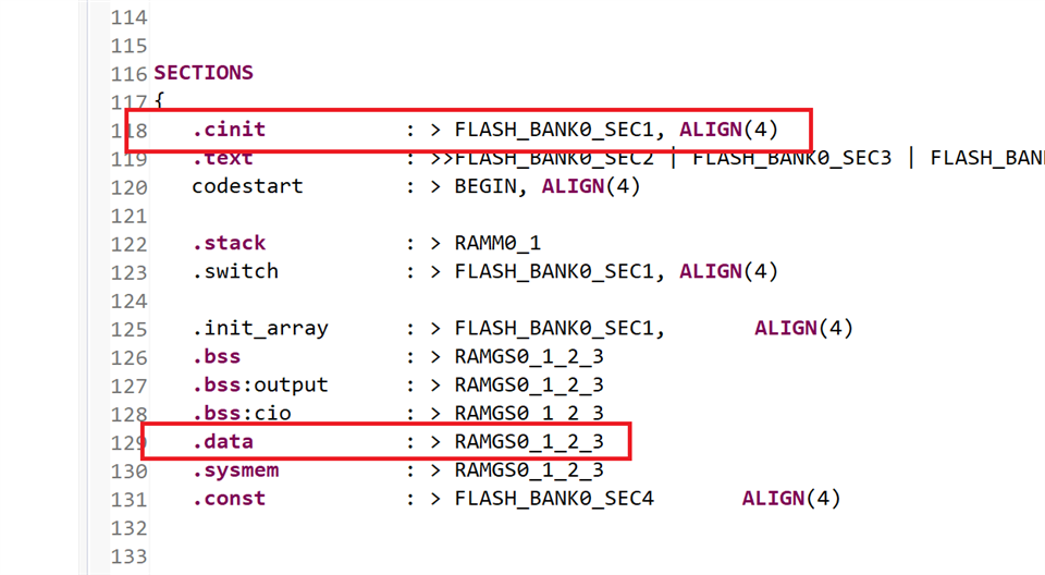

Dear Champs,
I am asking this for our customer.
They are asking what are the definition/difference/relationship between .cinit and .data in the linker command file (.cmd).
Would you please explain it in detail?

Wayne,
The .cinit sections contains tables which initialize global variables whereas the ".data" sections contains initialzed data.
Pls refer the following link which explains the different sections
