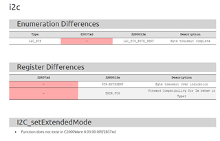

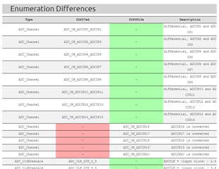

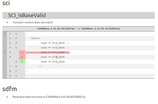

Part Number: TMS320F28375D
Other Parts Discussed in Thread: SYSCONFIG, C2000WARE
We are considering developing a new product using the F28375D software.
Due to board area limitations, we are considering replacing with small pin package piccolo series (F28001x, F28002x, F28003x, F28004x).
The peripherals used by the software are as follows.
・ADC
・SCI
・I2C
Since the CPU is the same and each IP seems to be similar, I think that the replacement itself is possible.
Is it possible to reuse the software for each peripheral? AIso is there anything I should be aware of when migrating?
